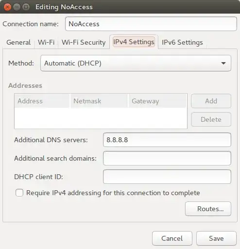

Google Public DNS operates recursive name servers for public use at the following IP addresses: 8.8.8.8 and 8.8.4.4 for IPv4 service, as well as 2001:4860:4860::8888 and 2001:4860:4860::8844, for IPv6 access. The addresses are mapped to the nearest operational server by anycast routing. I suggest you try those and see if you get better results.
I've found 8.8.8.8 to be very responsive. Open Network Connections and edit your entries as shown below. Then Click Save. This should resolve the issue.
