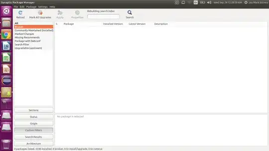

  • 5,359
You can use synaptic package manager and check the problems. enter image description here
