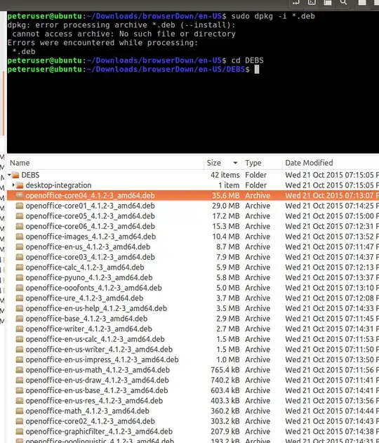

I've downloaded the .deb version from the website. A tar.gz file. Then I extracted it. It gives me 3 folders: DEBS, Licences, readme.
terminal
There are loads of .deb files. So am I installing the one with the largest size called core04, because I did do this:
dpkg -i openoffice-core04_4.1.2-3_amd64.deb
it is not working.
Go to DEBS folder and execute sudo dpkg -i *.deb
This installs Openoffice in /opt by default.
To install the Desktop integreations go into the dekstop-integration folder and execute the same command as above.
For further details please see here.
IF you want you can install all of them, but what's really important is that you install the core of the program. The core is basically the hub of the whole program (you will just see in dash as 'OpenOffice #' with # being the version number). It will install the rest of the program along with the libraries into the place you desire. As @Mustafa said,
So you probably won't have to change the installation path.
But if you do want to install desktop integrations (e.g. shorcuts and app links) Then you may wanna put it into the desktop-integrations folder.
