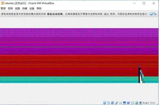

I tried to install Ubuntu in VirtualBox on my laptop (Windows 10 Home). I selected the ISO file I downloaded: ubuntu-16.04.1-desktop-i386.iso, and started it up from VirtualBox. But after starting, the interface became blurred and showed macroblocking like this :
bright coloured pixelated screen
I wondered if my ISO file goes wrong, but after using winMd5Sum it shows that the MD5 is the right one. I cannot find relevant messages. Could anyone tell me how to fix the problem?

I have found a solution to this but actually still don't know why.
The method is switch to console and then switch back to the GUI like the following:
  1. press right Ctrl+F1
  2. press right Ctrl+F7
Then the macro-blocking disappears and I can install Ubuntu as usual.

I had the same problem with Linux Mint 19 Tara in VirutalBox. I solved it with Input -> Keyboard -> Insert Ctrl-Alt-Backspace.
