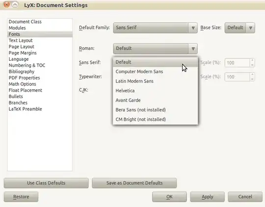

I use LyX for creating documents and would like to be able to format the output of my documents so that they use the Ubuntu font.
In the LyX document settings, it appears that there are only a fixed number of fonts available.
LyX: Document Settings
Is it possible to add the Ubuntu font to this list?

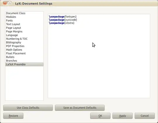

To allow this to render to a DVI/PDF/etc., some settings need to be changed in Document>Settings.
Click on 'LaTeX Preamble' and enter this into the text box:
\usepackage{fontspec}
\usepackage{xunicode}
\usepackage{xltxtra}
LaTeX Preamble

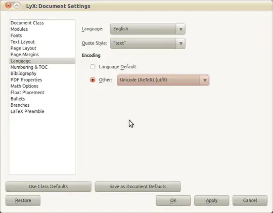

Also, under 'Language', set the encoding to Unicode (XeTeX) (utf8).
Language

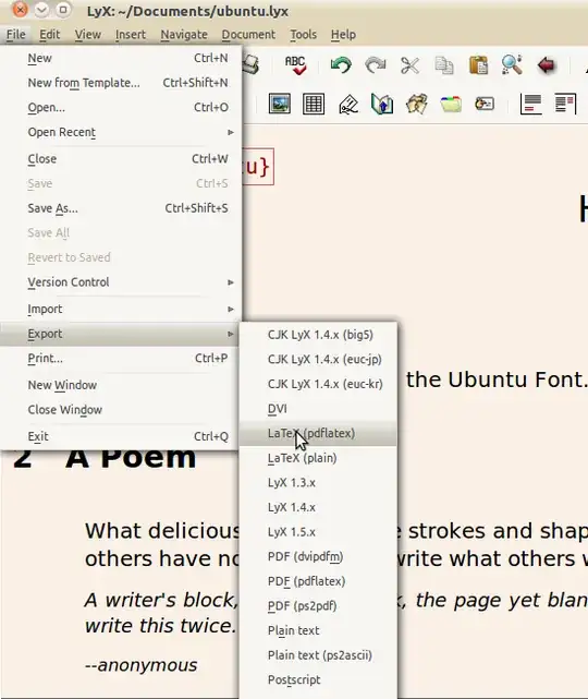

Now export the document as LaTeX(pdflatex):
export
This will appear to do nothing but will actually output to DOCUMENT_NAME.tex.

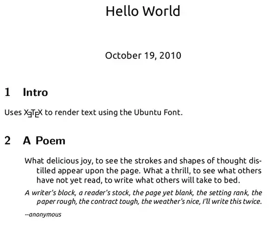

Now open a teminal (Applications->Accessories->Terminal) and enter:
cd ~/Documents
xelatex ubuntu.tex
xdg-open ubuntu.pdf
Replace ~/Documents with the path of the folder containing your document and ubuntu with the name of the document. This should create a PDF file of the output of your document and open it in the default PDF reader:
PDF output
Doesn't it look pretty? :D
