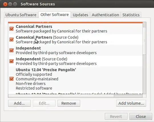

Remove the CD-ROM from the software sources.
Open System Settings > Software Properties and go to the tab "Other Software" (as pictured).
Select the CD-ROM and press Remove. Type your password when prompted. Close and accept the prompt to refresh.
Go to Settings - Software and Updates. On "Ubuntu Softare" tab, check the first four checkboxes and then in "Download from" dropdown select sane values or "Main server"
