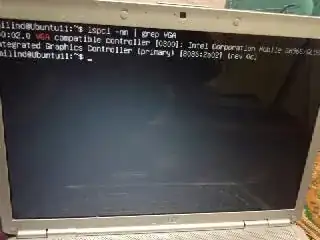

The important outputs of lspci are following:
00.00.0 Host bridge: Intel Corporation Mobile PM965/GM965/GL960 Memory Controller Hub (rev 0c)
00:02.0 VGA compatible controller: Intel Corporation Mobile GM965/GL960 Integrated Graphics Controller (primary) (rev 0c)
00:02.0 Display controller: Intel Corporation Mobile GM965/GL960 Integrated Graphics Controller (primary) (rev 0c)
I am attaching few snapshots, for more details on hardware.

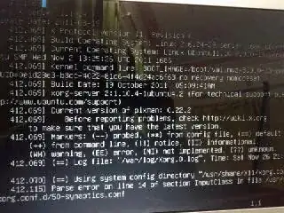

sudo vi /var/log/Xorg.0.log
It will give you the information, where exactly you are failing. For example, it was failing for me in one of the files which I wrongly edited. See the bold text below.
[    16.685]
X.Org X Server 1.10.4
Release Date: 2011-08-19
[    16.685] X Protocol Version 11, Revision 0
[    16.685] Build Operating System: Linux 2.6.24-29-server i686 Ubuntu
[    16.685] Current Operating System: Linux Ubuntu11.10 3.0.0-13-generic #22-Ubuntu SMP Wed Nov 2 13:25:36 UTC 2011 i686
[    16.685] Kernel command line: BOOT_IMAGE=/boot/vmlinuz-3.0.0-13-generic root=UUID=0e1d28e3-b3cc-4022-81c6-4f4d24ac6f63 ro quiet splash vt.handoff=7
[    16.685] Build Date: 19 October 2011  05:09:41AM
[    16.685] xorg-server 2:1.10.4-1ubuntu4.2 (For technical support please see http://www.ubuntu.com/support)
[    16.685] Current version of pixman: 0.22.2
[    16.685]    Before reporting problems, check http://wiki.x.org
        to make sure that you have the latest version.
[    16.685] Markers: (--) probed, (**) from config file, (==) default setting,
        (++) from command line, (!!) notice, (II) informational,
        (WW) warning, (EE) error, (NI) not implemented, (??) unknown.
[    16.685] (==) Log file: "/var/log/Xorg.0.log", Time: Sat Nov 26 22:59:34 2011
[    16.865] (==) Using system config directory "/usr/share/X11/xorg.conf.d"

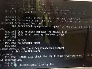

[ 17.051] Parse error on line 14 of section InputClass in file /usr/share/X11/xorg.conf.d/50-synaptics.conf "ppa:sergio91pt/synaptics+clickpads" is not a valid keyword in this section. [ 17.051] (EE) Problem parsing the config file [
17.051] (EE) Error parsing the config file [ 17.051] Fatal server error: [ 17.051] no screens found [ 17.051] Please consult the The X.Org Foundation support
I simply removed that line and rebooted. It again appeared with blank screen, I just tried randomly other tty section (e.g. tty2), by pressing Ctrl + Alt + F2 and I to my pleasant surprise I saw the graphical login screen!!!
