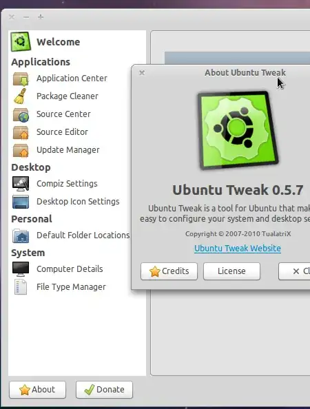

Ubuntu-Tweak doesn't have the option Startup which includes
  • Session Manager
  • Session Control and few other options are not there. I am running the latest version available to download. I remember having all those menus in lucid.
for a better difference comparison see the menus in the ubuntu tweak homepage http://ubuntu-tweak.com/ with mine....
alt text
how can I get these option back.

In the latest version (0.5.7) the startup menu has been removed, since it was a duplicate feature of the GNOME Session application.
See the release notes:
http://blog.ubuntu-tweak.com/2010/10/10/ubuntu-tweak-0-5-7-released-hello-ubuntu-maverick.html
Apart from that, you could try uninstalling ubuntu-tweak with
sudo apt-get purge ubuntu-tweak
reinstall, and see if it works.
Otherwise you should consider a bug report.

Figured out the problem, may be something wrong with the configuration files in the home folder's hidden files. Due to some other problem I had to empty my Home Folder and delete all the hidden files and after that Ubuntu Tweak is working fine with all the Options available.
