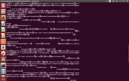

i am trying to read an odt file from terminal. When i type cat myfile.odt it shows me an image like this

Libreoffice format has the text within a compressed section of a binary file, so cat doesn't work. There is an option: lowriter --convert-to example.txt which will repackage it, & there is a --print option if that's what you wanted. man lowriter is informative.

cat works on text files. An odt file is technically (and very simplified) a ziped folder containing some xml files.
As such 'cat' can not be used for this purpose. It works only on plain text.
