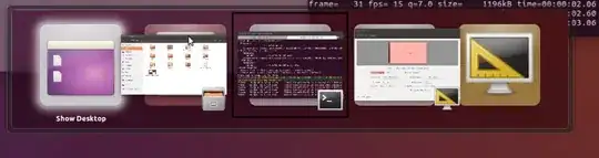

I have two Alt+Tab window switchers. It's super confusing to try to use them. This screenshot shows it pretty well:
How can I get back to the regular switcher (the one in the background)? I'm guessing the one in the front is the older switcher. It seems the current behavior is that both switchers are functioning, but the one on top get's the "last word." So the selected window in the bottom switcher will be second to the top, while the one in the top switcher will be in front.

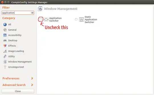

Run ccsm from the terminal, or search the dash for Compiz and open CompizConfig Settings Manager. If it's not installed, run:
sudo apt install compizconfig-settings-manager
In CCSM search for Application Switcher and uncheck the box beside it. The change should take effect immediately after you uncheck the box.
No idea what caused the problem in the first place.
