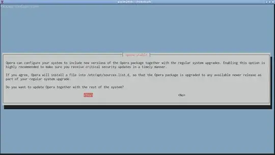

You can Install gdebi :
sudo apt-get install gdebi
Now you can install install any .deb package. It will download all dependencies.
sudo gdebi opera-stable_40.0.2308.62_i386.deb
After your dpkg -i command, run sudo apt-get -f install to install any further dependency. It should fetch required dependency packages.
