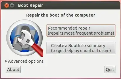

You need to repair the GRUB. Do the following
Boot using a Live USB/CD of Ubuntu. Use Boot Repair to fix the problem.
After booting with Live USB/CD, run following command in terminal:
 sudo add-apt-repository ppa:yannubuntu/boot-repair && sudo apt-get update && sudo apt-get install -y boot-repair && boot-repair
Use Recomended Repair. This will install GRUB back :) screenshot of boot-repair
