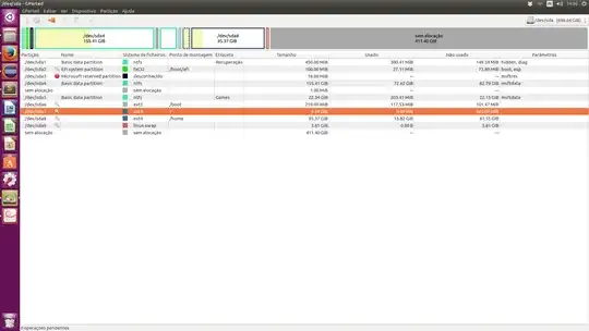

I have a lot of spare space in my hard disk. But the size of / partition is very small. Here is a snap of my partition table in Gparted,
How can I expand my / partition? Step by step description will be helpful.

From gparted live session ...
  • enlarge /home/ with the 411Gb unallocated
  • shrink /home/ and create unallocated space at the beginning of /home/
  • enlarge / with the unallocated space
When done ...

what you could do, is: First, move your swap (using Gparted, I think you'll know how to)
then you have two options:
1. You could either lazy unmount your home folder through the terminal, by typing
- sudo umount -l /dev/sda8
- then refresh the partitions in Gparted,
- move your home folder, and then enlarge your /
I thought I'd heard this should be possible without unmounting, otherwise use the live usb
  1. to do the live USB: follow the instructions on the Gparted website
    • reboot with the USB inserted
    • repeatedly press F9 on startup, select USB in the boot menu and you should be able to do anything you want.
    • move your swap
    • move your home folder
    • resize your root partition
    • don't forget to execute
    • reboot back into linux
    • happy days :)
