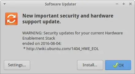

I got a prompt to install the latest Ubuntu HWE (Hardware Enablement Stack):
Upgrade HWE prompt
Without thinking, I clicked Install. After rebooting, I noticed the following issues:
