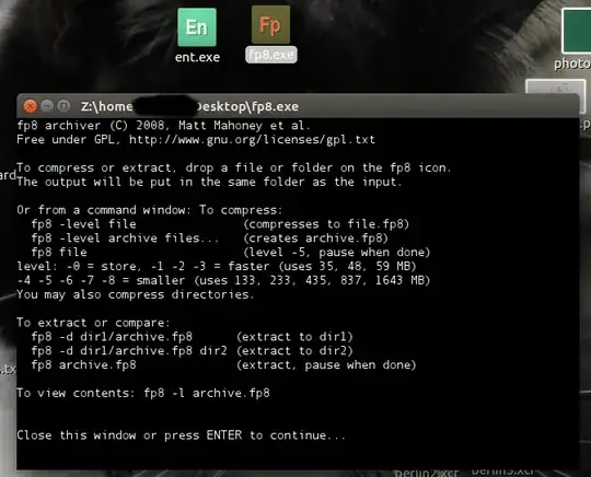

I'm trying to run Fourmilab's ent.exe and a file compression tool called fp8.exe. These are both DOS command line utilities that I have successfully run on Windows 7. I can't run them properly under Ubuntu 16.04.1 LTS.
I have Wine installed and it works with other Windows' stuff. So I click on either fp8 or ent. They both execute and a black terminal window opens. The two packages take command line arguments, and I can see that they are effectively executing without the arguments. I just see the help page for fp8, and a (for simplicity) black screen for ent.
So I fire up DOSBOX, and try to execute them from there. Both programs report "This program cannon be run in DOS mode." Well yes it can, as it does so on Windows, and they run non argumented under Wine. As here:-
fp8 executing under Wine
How can I run them interactively on a command line so that I can supply various arguments to them? I want to run:-

The way would be to specify the full path to the executable and prepending wine before it. Basically using file paths like this with the wine program, on the Terminal / command line:
wine /path/to/executable.exe [argument argument ...] PATH_TO_FILE_TO_USE
Note that not all CLI programs for Windows will correctly run in Wine - Wine may be a compatibility layer but there are many things which will not run under Wine.
This isn't really that hard. The three example commands from above but with Wine formatting and such:
wine /path/to/ent.exe /path/to/{this file}
wine /path/to/ent.exe -b /path/to/{that file}
wine /path/to/fp8.exe -8 /path/to/{another}
