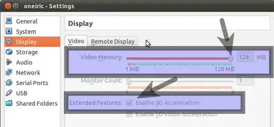

In VirtualBox settings you should change the video card memory and 3D graphics card setting. Your guest O/S will then see a "3D Accelerated card" with 128Mb RAM. It doesnt matter if your host graphics card is better than this - your guest O/S will only see this "simple" abstracted virtual graphics card.
Since you mentioned you are using a Windows Guest O/S - the 2D checkbox is applicable to you since a similar pass-through of programming interface calls is performed.
