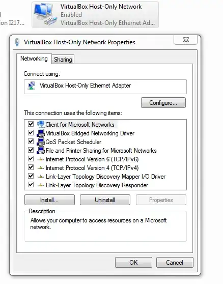

I'm trying to setup ubuntu 64 bit VM on my stupid windows 7 machine.
The Network information that the Windows is connecting to
Wireless LAN adapter IPv4 of the host machine - 10.11.209.93
Ethernet adapter VB Host-Only IPv4 - 192.168.56.1
I enabled virtualization in BIOS settings.
windows Host only configs
And, I also set the VirtualMachine network provider to be Bridge Adaptor.

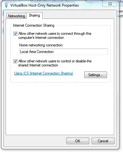

Also, have network sharing [which is not needed actually]
But, there's no connection in the ubuntu VM.

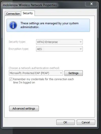

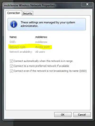

update: Your VM settings should include Bridged Adapter. Internet Connection Sharing should be off. Your enterprise network may give you trouble too... if so, talk to your network administrator for more help.
