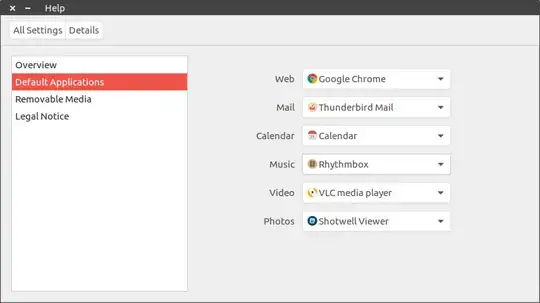

In System Settings / Details / Preferred Applications, Rhythmbox is set as default, but when I double click the mp3 it opens VLC.

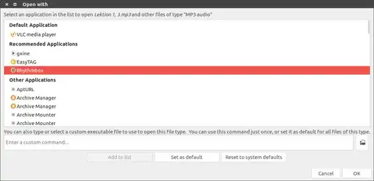

If I wish to change the default application, it doesn't change the VLC to Rhythmbox.

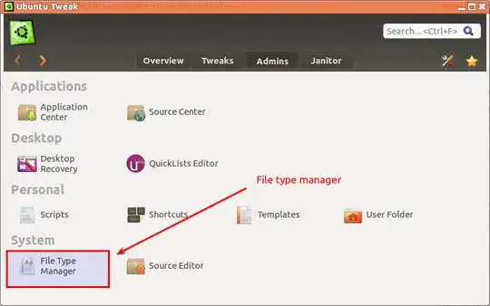

You can manage file type in Ubuntu-Tweak
1). Install Ubuntu-Tweak for Ubuntu 16.04 (More info about GetDeb Apps)
wget -q -O - http://archive.getdeb.net/getdeb-archive.key | sudo apt-key add -
sudo sh -c 'echo "deb http://archive.getdeb.net/ubuntu xenial-getdeb apps" >> /etc/apt/sources.list.d/getdeb.list'
sudo apt-get update
sudo apt-get install ubuntu-tweak
2). Open Ubuntu-Tweak and go to Admins > File Type Manager:
In the categories press Audio and select which File Type will be open with Rhythmbox
