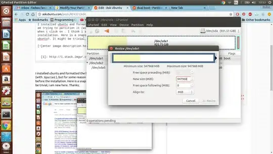

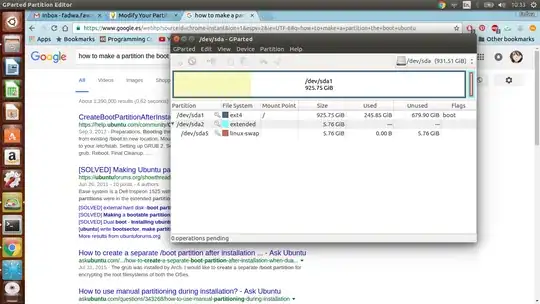

I installed Ubuntu and during installation I formatted all the hard disk by mistake. Now I am trying to partition it (with GParted), but for some reason I can't, when I click on resize, the size of the partition is not editable. I think I should've partitioned it before the installation. Here is a snapshot from GParted. enter image description here
Do I have to reinstall Ubuntu?

You cannot resize a mounted ext* partition. Boot the Ubuntu installer disk, choose Try Ubuntu and run GParted without mounting your hard disk.
