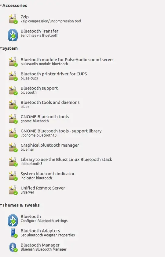

I have the following installed: software installed related to bluetooth
