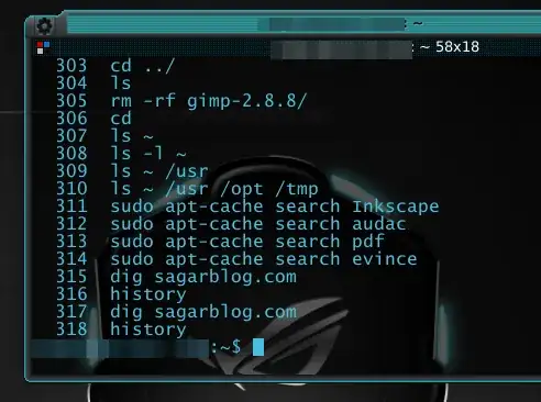

You will definitely see a list of commands you entered with serial number in the left side against each command say as follows. history example
well if you want to execute sudo apt-cache search Inkscape the slno concerned with that command in the above pic is 311 so in the terminal just enter
!311
