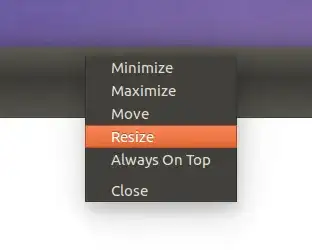

There are other methods, how to resize window, when the default method is broken.
1.
Right click on top panel and choose "Resize". Then resize window how you want.
2.
The second better method is keyboard shortcut Alt + Middle mouse button (wheel).
Hold down the Alt key and press and hold the middle mouse button.
I think that the second method is more comfortable then resizing through the window edges.
