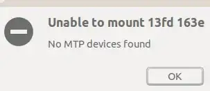

Other posts suggested adding a line with the vendor and product ids to /lib/udev/rules.d/69-libmtp.rules. When I do this, I get the following error dialog:
Is there anything else I can try to make this external HD enclosure work?
