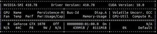

reboot and test using nvidia-smi command enter image description here
That's all should solve your problem. If you are having the same problem then try to install a lower more stable version of the driver. For example, I first tried with nvidia-430 and it did not work then tried with nvidia-410 and it was fine.
