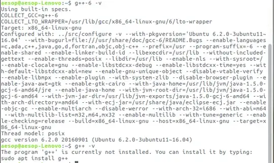

instead of g++ command O have to type g++-6 -v how do i fix this so that g++ command to g++-6
this is giving me problem compiling native extensions from ruby and might be trouble for other programs too

A more proper fix for this would be to make a symbolic link for g++-6 to g++. This will ensure compatibility with many installers and other applications.
To do this:
sudo ln -s $(type g++-6 | grep -oE '[^ ]+$') /usr/bin/g++
This will get the path to g++-6 and create a symbolic like using it to /usr/bin/g++
