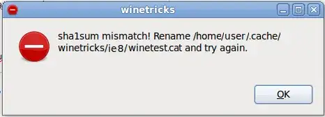

GUI Install via Winetricks GUI method
or using the GUI method, you should see a error dialog similar to this:
