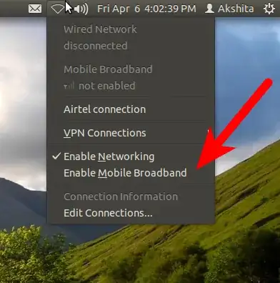

I would like to permanently check "Enable mobile broadband" so I don't have to check it after every boot.

Enable your broadband by clicking "enable broadband" in the network manager indicator.

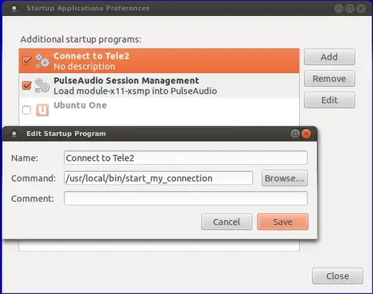

Finally, configure starting the script after login:
in Startup Applications Preferences add an item and enter the script path (/usr/local/bin/start_my_connection) as the program command.
