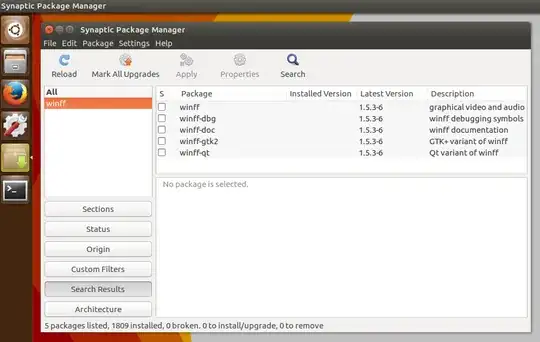

The screenshot below demonstrates that unlike the Software Center Synaptic clearly displays WinFF:
WinFF will not appear in Dash immediately after installation and even opening and closing Dash before trying again will have no effect. However if you log out and then log back in you will see the following:
