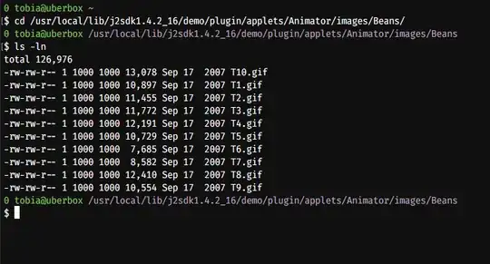

This is an answer to your problem (long directories break the command line) and not specifically to your question (how to change the command prompt on the fly.)
I solved this problem years ago with this prompt:
PS1='\[\e[32;1m\]$? \u@\h \[\e[35;1m\]\w\[\e[m\]\n\$ '
#    └──green───┘         └──purple──┘  └─norm─┘
What this does:
  1. output the exit value of the previous command (this is incredibly useful)
  2. output the current user and host in one color
  3. output the working directory in another color (adjust the colors to your taste)
  4. output the dollar and space on a new line, ending the color sequences before the line break
This gives you all the space you need for your command, does not shift it right when you are in a deep directory structure, does not mangle the typing line with color codes (avoiding strange bugs that happen sometimes), while still giving you the colored hint on where the output of one command ended and the next one begun:
