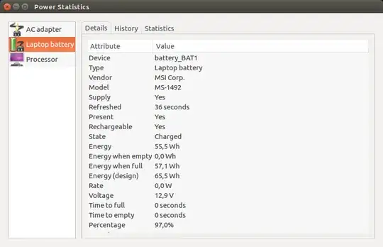

As you see Ubuntu shows that my battery is in a charged state at 97%. My laptop is almost 3 years old (battery as well). How should I understand these 97% and are they correct? Under Windows, there is a MSI tool for calibrating my MSI battery, but under Linux I do not know what to do. Appreciate any help in terms of that matter. Thank you.
upower -d output:
katsarov@Katsarov:~$ upower -d
Device: /org/freedesktop/UPower/devices/line_power_ADP1
  native-path:          ADP1
  power supply:         yes
  updated:              Di 06 Sep 2016 16:53:50 CEST (1136 seconds ago)
  has history:          no
  has statistics:       no
  line-power
    warning-level:       none
    online:              yes
    icon-name:          'ac-adapter-symbolic'
Device: /org/freedesktop/UPower/devices/battery_BAT1
  native-path:          BAT1
  vendor:               MSI Corp.
  model:                MS-1492
  power supply:         yes
  updated:              Di 06 Sep 2016 17:11:50 CEST (56 seconds ago)
  has history:          yes
  has statistics:       yes
  battery
    present:             yes
    rechargeable:        yes
    state:               fully-charged
    warning-level:       none
    energy:              55,5333 Wh
    energy-empty:        0 Wh
    energy-full:         57,1428 Wh
    energy-full-design:  65,49 Wh
    energy-rate:         0,0111 W
    voltage:             12,878 V
    percentage:          97%
    capacity:            87,2542%
    icon-name:          'battery-full-charged-symbolic'
Device: /org/freedesktop/UPower/devices/DisplayDevice
  power supply:         yes
  has history:          no
  has statistics:       no
  battery
    present:             yes
    warning-level:       none
    energy:              55,5333 Wh
    percentage:          97%
Daemon:
  daemon-version:  0.99.4
  on-battery:      no
  lid-is-closed:   no
  lid-is-present:  yes
  critical-action: HybridSleep
Battery window: enter image description here

That battery appears to be in fairly good shape for a 3 year old laptop with 87% of original capacity remaining, not "broken" at all.
Looking a bit more closely at your output:
energy:              55,5333 Wh
Looking at "energy rate", the battery is actually still charging, just at a very slow rate, something not uncommon when the battery is nearly full.
It appears that the battery controller just signals "fully charged" due to the very slow charge rate (also not uncommon, just a convenience for the user), e.g. it tries to tell you this:
Just go ahead and unplug the device now, because topping the battery off will take a long time.
Leave the laptop plugged in, and you will see the battery charge creep up to 100% very slowly.
My laptop does the same thing, it will show "fully charged" (and even a green LED on the charger will light up) as soon as it reaches 95%.
This makes perfect sense, since charging it from 10% to 90% takes 2 hours, from 90% to 95% takes 30 minutes, and from 95% to a full 100% can take another 1-1.5 hours.
Edit:
To answer your question in comment "it is plugged in for 24 hours already", and given the very low rate at which it charges currently, this can be a sign that the part of the battery that is still charging is about to fail, again very normal for an aged battery.
In this case, the battery controller will soon update the "energy-full" value (likely after plugging it out and restarting the device from being turned off) to the new capacity.
With your output above, you'll probably then be looking at a remaining total capacity of about 85% instead of 87% like you have now, which is still excellent for a 3 year old battery.
