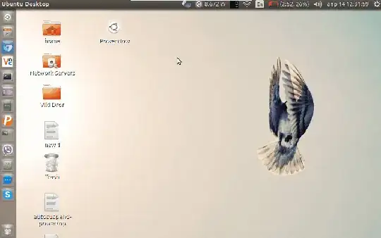

Instead of counting monkeys :-), I modified the second script from L. D. James's answer to show the current power consumption of my laptop in watts.
The script works with Ubuntu 16.04 and probably the only system specific thing is the file where the value of the current power consumption is stored. In my case I found it by the help of tlp:
$ sudo tlp stat | grep -P '\[m(W|A)\]'    # Output on Lenovo ThinkPad X230 Tablet
/sys/class/power_supply/BAT0/power_now                      =  11246 [mW]
$ sudo tlp stat | grep -P '\[m(W|A)\]'    # Output on Dell Vostro 3350 Laptop
/sys/class/power_supply/BAT0/power_now                      =  6700 [mA]
Note some devices provide the current power consumption in watts, but some devices provide the current values of the voltage and the current (amps) - and the script covers these cases.
Further I created the GitHub Project PowerNow and added additional options: to execute htop, powertop or tlp stat within a gnome-terminal.
