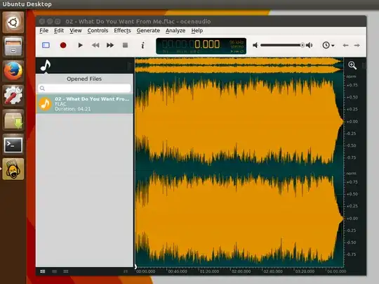

I have tested it comprehensively and it runs well with no security risks that I could see. Nice application too:
So my personal recommendation: do some further research on Ocenaudio, add my own thoughts to your research and then install and enjoy this great application :)
