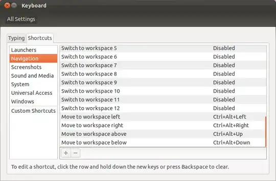

19
In my system, those configs are available in System Settings -> Keyboard. Please double-check.

Finally, in Ubuntu 22/04 this can be disabled using System Settings -> Keyboard -> View and Customize Shortcuts -> Navigation. In there, find Move to workspace on the left and Move to workspace on the right, click on each entry and re-assign Super+Page Up and Super+Page Down respectively. This will disable any other assigned shortcuts.

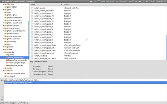

open gconf-editor.
Go to /apps/metacity/global keybindings and change the values according to my screenshot:enter image description here
