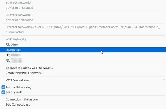

I'm seeing two Ethernet network() Device not managed errors in my network manager menu as well. I'm not sure when did these two entries start appearing.
Update 3
I did some more research and figured out that these two interfaces were created by VMWare Player software that I recently installed.
