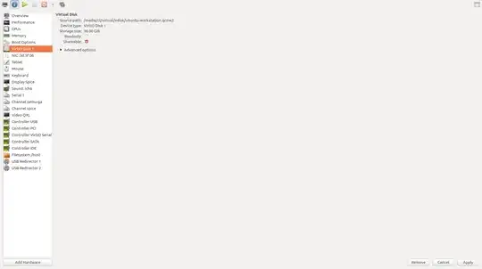

Open the virtual machine in virt-manager - select the disk - mark Shareable - click on Apply.

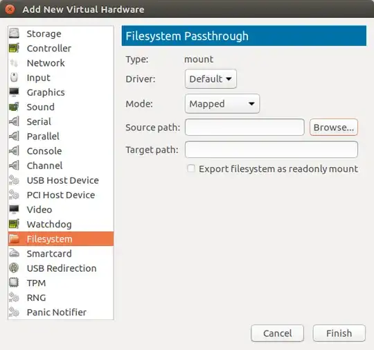

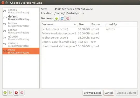

Click on Add Hardware - select Filesystem - change the Mode to Mapped - click on Browse.

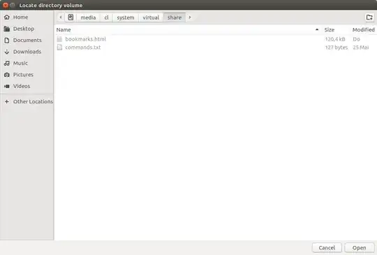

Click on Browse Local.
Select the folder you want to share with the guest operating system - click on Open.

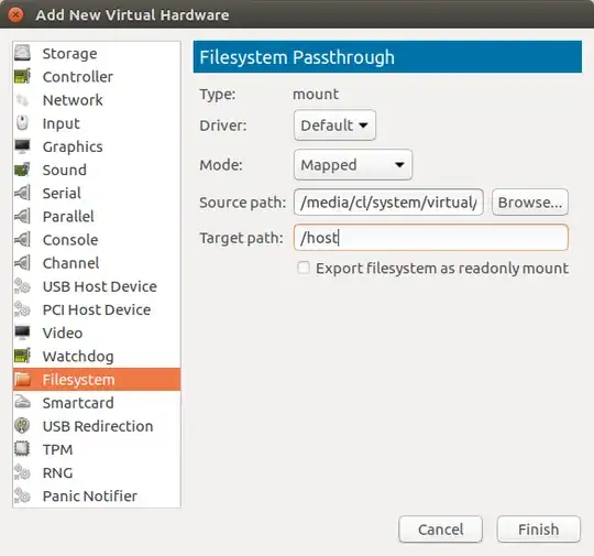

Type /host into the field Target path - click on Finish.
