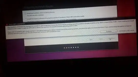

below is my screenshot when installing Ubuntu..

And I am having below error when I install Ubuntu. Please check this image and let me know why this Error is :
Please help me, thank you !

Okay, Since you said HP Notebook R15 , I'm assuming you also have the same BIOS Setup as I have in my HP Notebook. Plug in your bootable USB and press F9 repeatedly when you start-up your laptop. You will be lead to a boot manager and there you will see * 'Your pendrive name ( UEFI ) and * Your pendrive name only without UEFI
Choose withut UEFI and check whether there is "Install Ubuntu along Windows 10" option.
Please let me know if it fix your problem.
