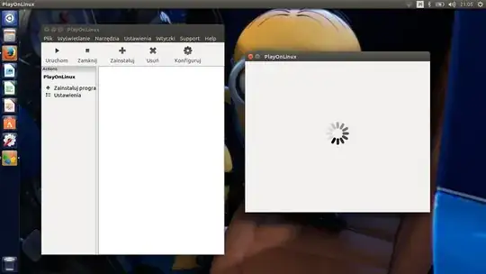

I'm new here. I tried to install League Of Legends game via PlayOnLinux, but after choosing LOL from list of games and clicking next I see no progress, just loading all the time.
game stuck screenshot
Can anyone help me?

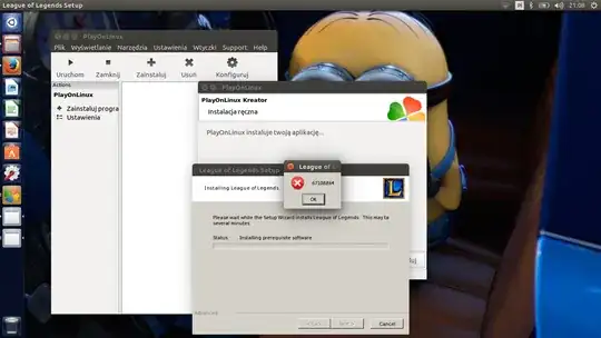

I tried also to install with .exe file and got many errors like thisone in the image bellow.
league of legends playonlinux error
I run Ubuntu 16.04 LTS x64.

There is a r/Ubuntu post in Reddit by jmobastos69 that details how to install League of Legends (LOL) in PlayOnLinux (POL). This answer is a cleaner and slightly modified version of that post.
  1. Remove wine and playonlinux and their dependencies that you have installed previously and remove retrieved package files:
    sudo apt purge wine playonlinux
    sudo apt autoremove
    sudo apt autoclean
  2. Clean install the staging branch of winehq and wine for the 32-bit architecture using Wine's installation instructions for Ubuntu:
    sudo dpkg --add-architecture i386
    sudo add-apt-repository ppa:wine/wine-builds
    sudo apt update
    sudo apt install --install-recommends winehq-staging
    sudo apt install wine:i386
  3. Install playonlinux:
    sudo apt install playonlinux
  4. Start playonlinux as a background process in the terminal:
    playonlinux &
  5. Save the following script with a name of your choice (note that I copied and pasted the script from jmobastos69's link to this answer so that the script can be audited by everyone here):

  6. Choose "Run a local script" from the "Tools" menu of PlayOnLinux and select the script you have just saved.
  7. Follow instructions to install League of Legends. Remember to uncheck the "Launch League of Legends" box at the end of the installation wizard.
  8. In PlayOnLinux, press "Run" on the League of Legends app.
