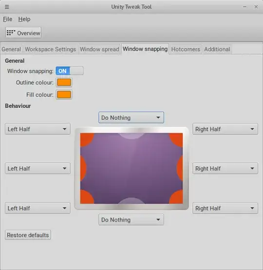

        - Open Unity Tweak tool.
- Go to Window Manager section
- Click on Window Snapping
- Under Behaviour, There is screen. On the top of it, There is a pop-up selection menu.
- Select Do Nothing from that menu.
- You can repeat selecting Do Nothing for other sides if you want.
If you don't have Unity Tweak Tool installed, install it with
sudo apt install unity-tweak-tool
command in a terminal
Here is a screenshot of that settings window
