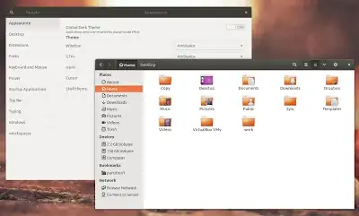

But the majority of my other apps have the Slate Title Bar
  • although the DropDown menus are displaying correctly

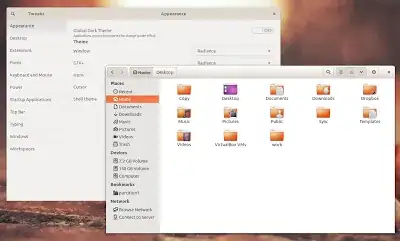

Here is an example of what I want:
Here is an example of what I get currently:

open dconf Editor from Menu/System tools, go to org/gnome/metacity/theme and type Radiance instead Ambiance
credits to this dude https://askubuntu.com/a/820346/590091
