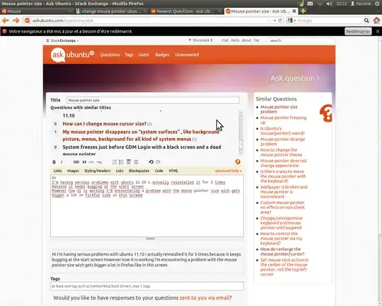

I'm having serious problems with ubuntu 11.10 i actually reinstalled it for 3 times because it keeps bugging at the start screen However now it is working i'm encountering a problem with the mouse pointer size wich gets bigger a lot in firefox like in this screen :

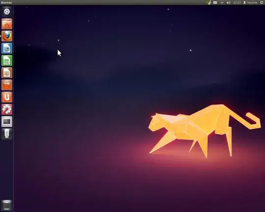

And when i'm on the desktop it gets this size :
Thanks a lot i really don't know what i should do :)
Jorge Castro
  • 73,717
Those mouse pointers are exactly the same size. Measuring both cursor dimensions in GIMP shows that they are both 25px wide and 39px high (depending on where you take the threshold of the border blur, of course, but it's still consistent). It only looks smaller on the desktop because the black border of the pointer is not visually distinct against the dark desktop background.
