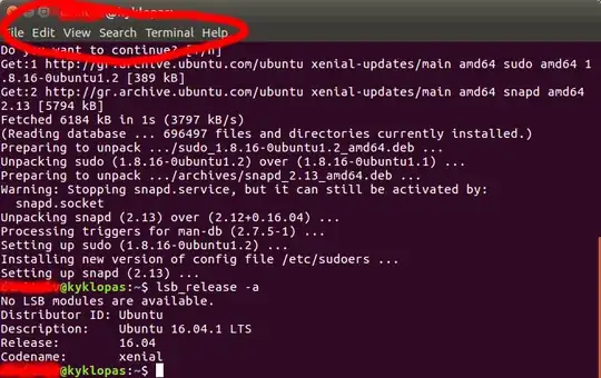

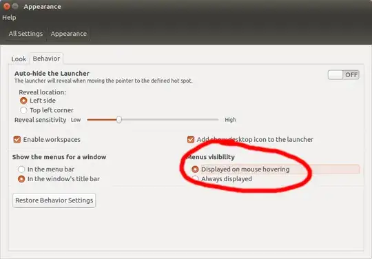

For the windows that have a menu bar, it is always displayed, regardless of the value selected in the "menus visibility" setting. See figures below:

Your system is missing the indicator-appmenu package. Without that package you won't get the application menu on the titlebar in Unity session.
And reinstalling ubuntu-desktop package wasn't fixing the problem because for some unknown reason, this package wasn't included in the dependency list of ubuntu-desktop package for 16.04 (You can check it by using apt-cache depends ubuntu-desktop command).
So, to fix the issue, install the package with this command
sudo apt-get install indicator-appmenu
