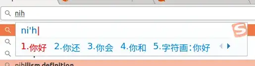

I haven't found the right setting for Chinese input, IBus pinyin. If I want to write "ni hao" the correct alternative shows up after writing "nih" (as second alternative). But if I continue writing "niha" or "nihao" it will show something like "你哈". It seems it does not accept more than two characters per syllable?
I am used to writing the complete pinyin and not checking after every stroke if the correct alternative is in the list. Can I make it work like that?

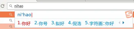

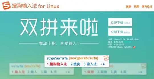

fcitx should have better supports for all Chinese input methods.

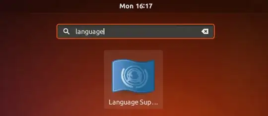

  1. Switch the input system to fcitx in Language Support. (If you don't know what is "Language Support", just search it on the dash.)
  2. Download the latest Sogou PinYin fcitx plugin from this.
  3. Double click to launch Ubuntu Software to install the deb installation pack.
  4. Relogin your account.
  5. Try to switch to sogou pinyin input method under the fcitx input method list in the right-hand side of the top bar.
  6. Type nih or nihao.

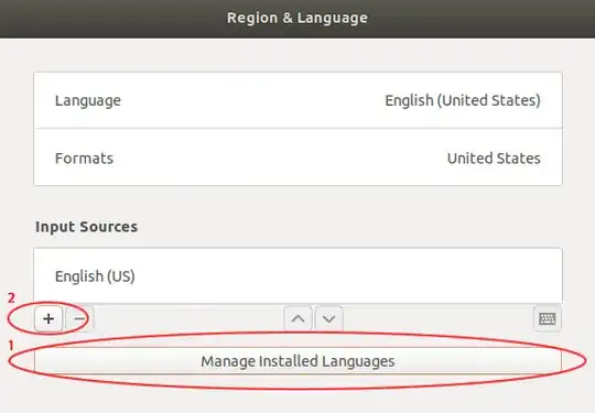

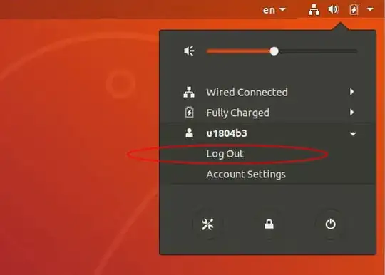

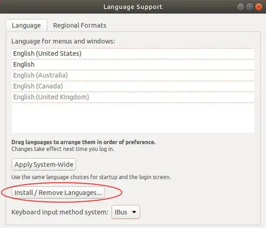

There are 3 steps to the process:

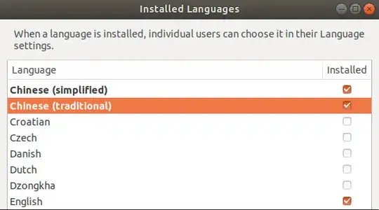

  1. Add Chinese language support and select IBus input.
  2. Logout and back in
  3. Add pinyin input method
The following is copied from http://pinyinjoe.com/linux/ubuntu-18-gnome-chinese-setup.htm
1) Add Chinese Language Support and Select IBus:
Make sure to select IBus as Keyboard input method above.
2) Logout and Log back in:
3) Add PinYin Input:
