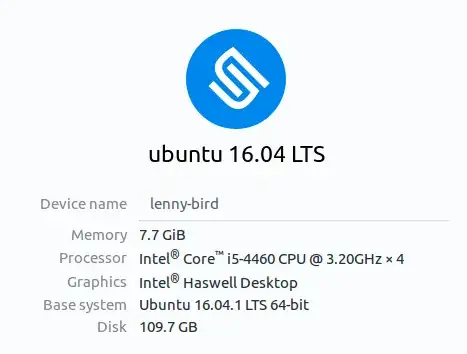

I have an Ubuntu computer running 16.04, and I only have one graphics card.
Specs
My brother and I constantly fight over who gets to use it, so I'm trying to do everyone a favor and install multiseat.
