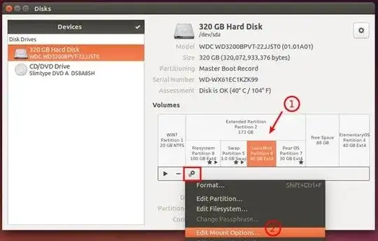

I'm trying to change the default permissions of some automounted USB drives which are VFAT, and by this image:
http://ubuntuhandbook.org/index.php/2014/07/mount-partitions-automatically-ubuntu-14-04/ edit-mount-options
... I guess that I could do it from gnome-disks. However, this PC is:

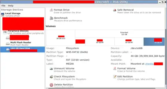

... and so it doesn't have gnome-disks, it has palimpsest instead. So I tried opening both as regular user: palimpsest, and as root gksu palimpsest, but I get the very same screen:
palimpsest
That is - there is no cog icon anywhere, there is no "Edit Mount Options" anywhere either.
So I just wanted to make sure - does palimpsest in Ubuntu 12.04 have a cog-icon/"Edit Mount Options", but I have my PC misconfigured (i.e. maybe I have missing packages) - or is it incapable of changing mount options by default?

As far as I remember, gnome-disk-utility had no edit mount option at that time. It had Edit FileSystem Label, FileSystem type etc options.
I have one 12.04 ISO still now, but I think this question's screenshot will prove it. The OP here was running 12.04 and the screenshot is from gnome-disk-utility. There was no cog icon. It was later introduced.

And the Ubuntu handbook was featuring a 14.04 gnome-disk which is different than 12.04's gnome-disk-utility
