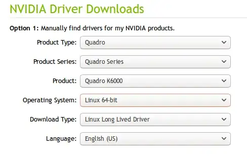

So you see im using a Quadro K6000. Head over to NVIDIA Drivers entry page and search the proper driver for your card:
NVIDIA search based on lspci -vnn | grep VGA
Click search and download the driver to your desktop.
