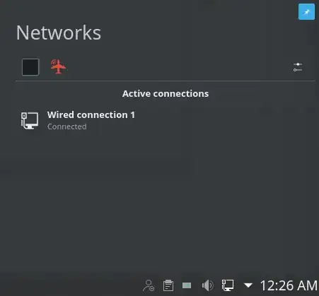

Network Manager System tray menu doesn't show option for wifi. It shows airplane mode button but wifi button which should be next to it is missing. I have just installed Kubuntu 16.04 and this problem is there since the install. I got a detailed analysis report on computer network by running command:

Please help me as I am unable to access wifi networks on Kubuntu but they work perfectly fine on windows 10 which is dual booted with Kubuntu. Can anybody suggest a solution?
** I don't refrain from saying that this is not a duplicate question, but being a new user it is difficult for me to relate between wifi problem and the question about "Required key not available". Nevertheless, my issue is resolved and Thanks a lot for help! :)
