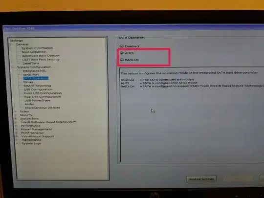

I run into similar ubi-partman crash 141 exit code. Though I could not find any easy solution. Though, my platform is desktop Dell OptiPlex 7040, SSD TOSHIBA NVMe THNSN5512GPU7 (18 RAM, CPU i7-6700); I wanted to install Kubuntu 18.04 LTS, and after successfully booting from USB flash I stopped on ubi-partman crash 141 exit code in installation process (you cannot go to partition/disk settings).
I tried disable Fastboot on Windows 10 (yes I wanted dual boot) but just this did not work.
(see for example:) https://help.uaudio.com/hc/en-us/articles/213195423-How-To-Disable-Fast-Startup-in-Windows-10
I also noticed in BIOS settings, there is RAID ON. I actually do not know what it means, but if I changed it to ASCI:
https://support.thinkcritical.com/kb/articles/switch-windows-10-from-raid-ide-to-ahci
Error 141 disapeared and I was able to install Kubuntu. (so SATA was set to AHCI and Fastboot on Windows was disabled)
It is worth to backup Windows, though I did not do it, because system was clean. Switch operation is not without risk - I read it is possible you will not be able to boot your Windows - though I had no problem.
