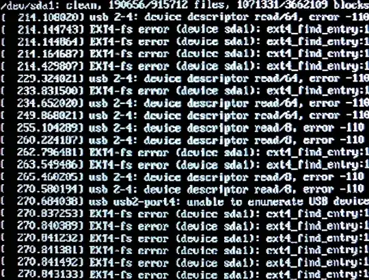

I burned a live USB of Ubuntu on a flash drive nad I used it to install to a different flash drive which does not work fine.
Specifically, the one it's installed on is 16GB and the boot goes a little like this: I boot the computer, I get to the log in screen, I log in, and after that it goes black displaying the following errors:
screenshot
Basically, I get multiple lines saying:
EXT4-fs error (device sda1): ext4_find_entry:[number]
What's going on? How do I fix this? I use an Asus CM5571.
Your have input/output errors on the drive. This can have two causes:
  • the file system is damaged
  • the drive is damaged
In the first case, you can easily solve it by running a file system check. You can use the live USB you have (the one that works fine), run it and open Gparted after plugging the faulty drive. Then:
  • select the faulty drive from the dropdown menu
  • click on the main partition
  • click on Partition → Check
  • follow the instructions
However, if the drive is faulty there is little you can do. You should think about getting a new one before it's too late because you risk losing data.
