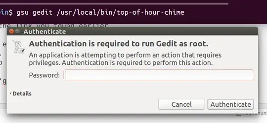

As a quick example to finding the application, I'll illustrate using my own script. I wanted to replace gksu which is being deprecated with pkexec so I wrote a wrapper script called gsu.
I invoke gsu from the command line with:
gsu pkexec
Notice the Details drop down arrow. Click it and this is revealed:
gsu pkexec details
In my example the pkla is controlled by org.gnome.gedit. I'll use that in the next example, which you would replace with your own:
