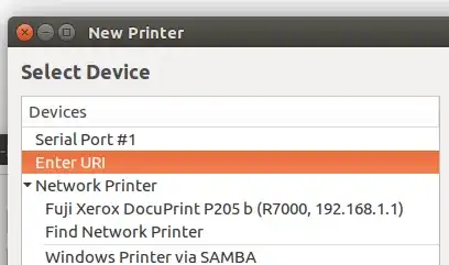

I can find my printer under the Network Printer. enter image description here

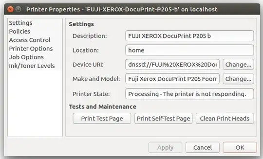

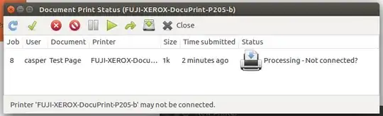

But after the configuration, I cannot print a test page. enter image description here
Printer Properties
